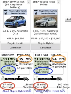

I've been comparing costs of PHEVs with hybrids and found that driving a PHEV within its battery range (electric only) costs more than driving a hybrid. I don't trust my result, so please clue me in. I used the EPA range divided by the battery size to get the miles per kWh then divided my electricity cost by miles per kWh. A sample result was 3.31 miles per kWh for the Prius Prime. At $.28/kWh (yes, California energy is expensive) the Prime costs $.0861 per mile. Its hybrid brother gets an EPA mileage of 57 mpg. At $4 per gallon (again, California energy) it costs $.0702 per mile to drive the mixed energy hybrid- about 18% cheaper. Every one says the PHEV energy cost savings will make up for the initial higher purchase price. My numbers say not true. So... what did I do wrong?
I want to circle back to the OP
While this is an honest evaluation, it is also pretty much worst case.
A better comparison is how many miles did you get out of that tank, or how many miles per gallon over a year compared to kwh consumed in an EV or PHEV.
What does a prius regular hybrid actually get for overall mileage? quick look says maybe high 40s. That is really where the error is. Little over 8 cents per mile real world rather than a little under
What does a prius prime cost to charge? at .28/kwh and 11.5kw for a full charge, 3.22
That should get you about 40 miles, .08 per mile.
Different electric and gas costs will change that
I think my electric/gas costs will flip that the other way since my gas is somewhat cheaper
