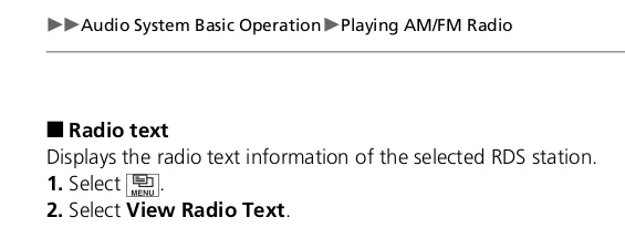

Well, This may seem like an obvious and dumb thought, but from the manual, there is a way to turn off (or on) the radio text.
It is bizarre that you get the auto shop info, but maybe the text display got turned off somehow, and it is just frozen (displaying something from the past), and if it is turned back on, it will overwrite the bogus information:
I have done that already....It doesn't turn the text on or off, but only just shows what text is being displayed....which is the auto shop info with no way to reset it...still digging into the menu to see if I can turn off RDS..
