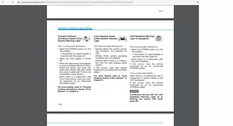

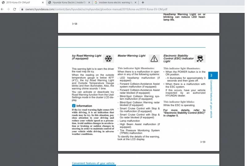

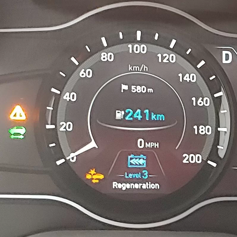

ehatch
Master warning light , plus FCA came on simultaneously today as I reversed into a parking spot.At least this is when I noticed them as they stayed on while I "idled,"and drove away. No collision, radar's clean. Never a dull moment at this point :confused: I do have a service booked for my hiss/squeak/sometimes clunking Kona EV. VERY curious what DTC codes will appear.

Very strange indeed - why would Forward collision avoidance come on when reversing ... seems like you were avoiding FCA as best as possible

I had the exact same lights come on only I was driving on the freeway with no one with in 200 yards of me. It was dark and I was in cruse control at 65 mph. and it just came on and stayed on until exited the freeway about 4 mile later. I came to a complete stop and when I pull away from the stop sign it went out. It did not come on on the return trip home. I am guessing may be I picked up some debris on the bumper that fell off when I stopped maybe a shopping bag or piece of paper that then blew away

There was a report somewhere (can't remember if it was this forum) where a leaf blocked the radar (a real one from a tree - not a Nissan).
@Fastnf I have ceramic coated the radar to avoid debris. There wasn't anything on the radar given I was in gridlock traffic.MANY stops by the time I pulled over,and noticed the two alerts.
Maybe the ceramic coating does something to it occasionally? I doubt it, however I never had problems, even after a 400 mile drive with lots of bugs to wash off.
