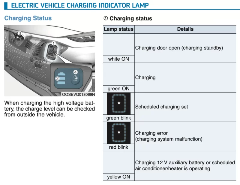

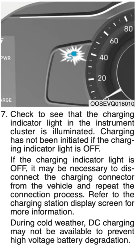

You haven't mentioned if the charge port lighting came on to indicate the car is looking for an EVSE, nor if the red charging symbol was "on" on the dash.
There have been no other similar reports that I'm aware of.
When I first connected the tethered Type 2 cable to the charging port (with the car powered down) the charge port lighting did not come on. But there was the charger connected symbol lit up on the dash. There was no indication of actual charging on the dash though. Once I turned the car on I heard the "clunk" of relays switching in the car and the light on the wallbox started to pulse and charging started. Then on checking the port it was illuminated green. Then I could power down the car with charging continuing.

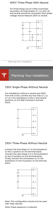

We've had very few '3-phase' OBC Kona owners on the board being as it's mostly US and Canadian members with a sprinkling of the commonwealth. There certainly have been charging problems with the 1-ph Kona but nothing quite like this. I'd venture it's related to the 3-ph unit and perhaps even the Tesla Wallbox wiring, see the installation instructions below, in particular the 3-ph no-neutral situation.
View attachment 11427 View attachment 11428
