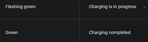

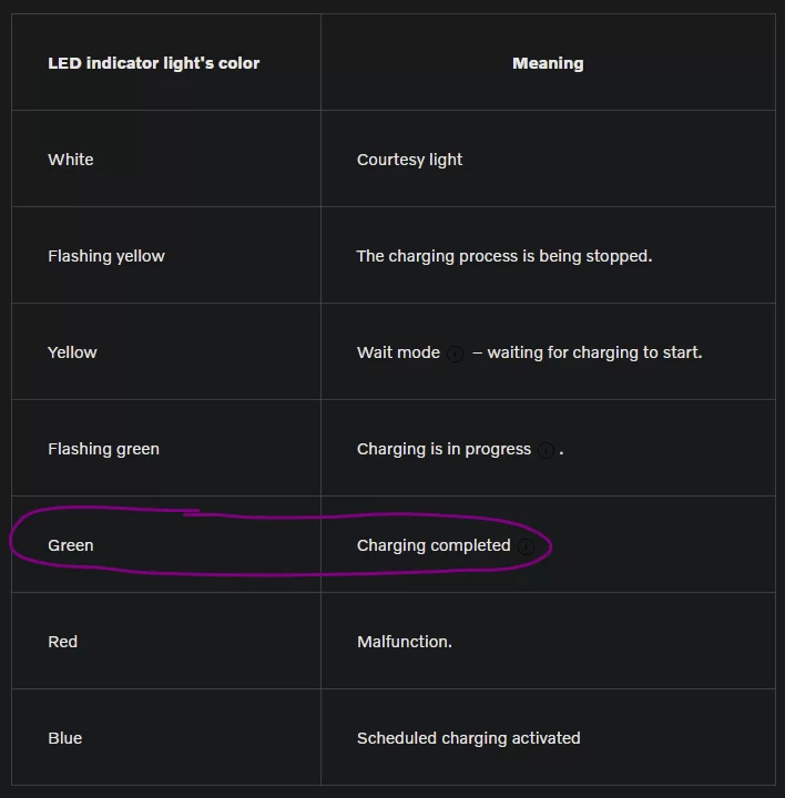

Maybe you are reading the wrong manual. It clearly states that the Green means charging completed. Yours wasn't blinking green in the video:
You clearly don’t own a XC40 Recharge, when car is not charging charging port shows white light or done charging it’s show no light. When cable is disconnected it show white light. Green light always when in middle of charging.
