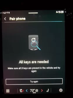

Trying to pair my phone with my car for Volvo On Call, I get this. Any ideas? Both keys are in the car, but can’t get past this screen.
I get stuck there too... My key is in the car with me, so... maybe they're talking about some other kind of "key"? I see people in this thread talking about a " Manual Activation code ", but I honestly have no idea if that thread even exactly relates to this issue....

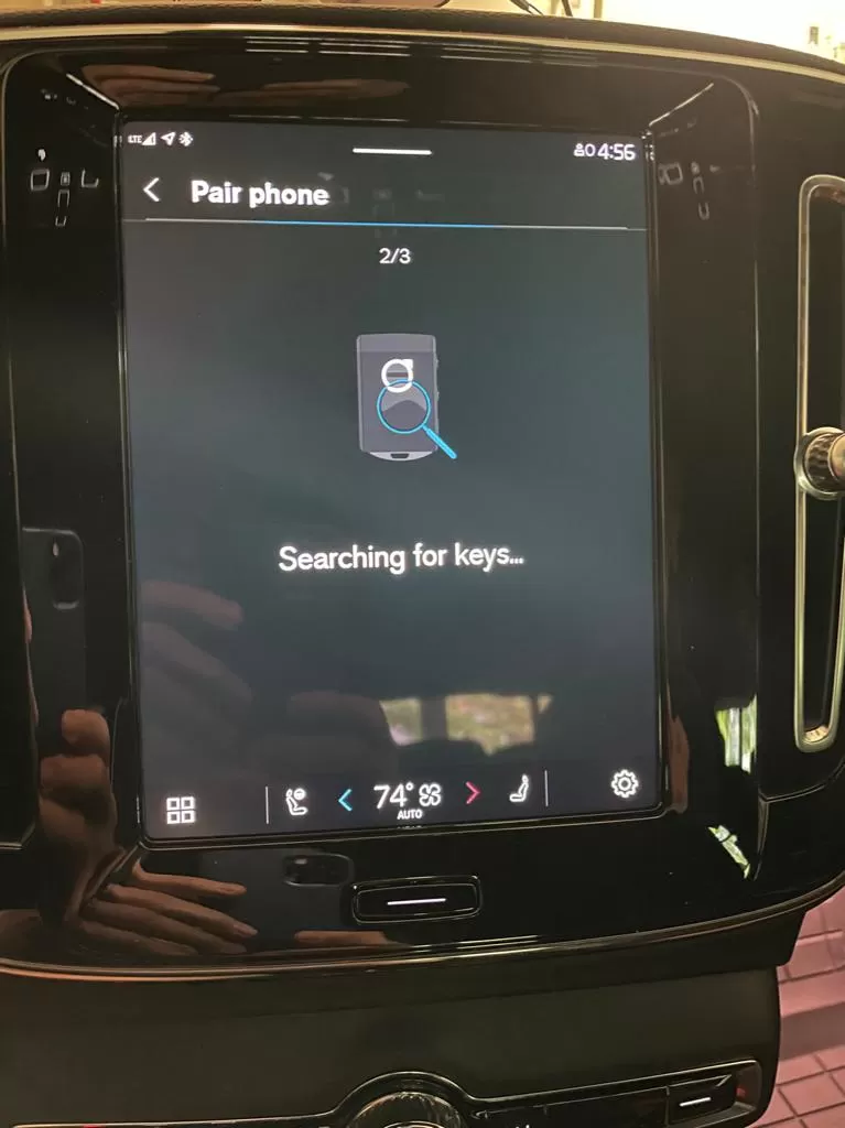

Hi,
I know this is an old thread, but the "2/3" does appear to mean you need all three key fobs in the vehicle (see photo attached) while registering your phone as a Volvo on-call device, at least within the "Admin" driver/user profile.
Oddly, it didn't seem to want all three keys when I registered a different phone as an On-Call device in a different driver's user profile (not the Admin).
R,
Will
Do you already solve this problem? It is the same as mine. If the problem is sloved, please give me the solution.
All,
I have also confirmed with the dealer that all keys the car knows about must be present to pair "On Call" mobile devices.
One correction to my earlier post: I was wrong about the "2/3" meaning number of keys found. The dealer and I confirmed that it *does* mean "Step 2 of 3". It is a coincidence that most of us happen to have three keys (two black regular keys and one orange valet key).
In my case, I had lost the orange "valet" key that came with the car, so I did not have all three keys nearby or in the vehicle and the pairing would not get past Step 2.
Therefore, I had the dealer reset the programming to remove the orange key from memory, leaving me with just two keys. Then the pairing worked to completion. It cost about $250, less than buying a new orange key *and* reprogramming the car would have cost.
If I ever find the orange key in my house, I can go back and have them add it back to the car memory. They may charge me money to do the programming again, though. :^(
