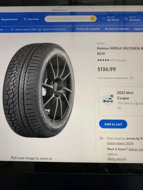

I'm another Nokian fanboy. For Maine, I'd seriously consider WR-G4s all year if I was on a budget.
Down in NC, they are my 'winters'. Warm wet grip is down a notch on the summer Hankooks, though.
They are better than any all season on snow/ice, though not as good as the best real winter tyres. Similar in summer dry weather to all seasons. Only warm and wet is a notch down on good all seasons, but not cheapos. Life is pretty good. I've only just put them on my '23 SE, but I've done a lot of miles on them with my R53. I'm not seeing a noticeable range reduction on mine.

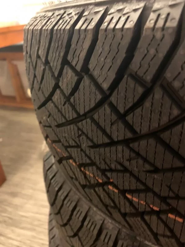

I got Nokian Hakkapeliitta R5. Really like the look and tread design. Have already tried them out on ice with no problem at all, but waiting for the first snow. I think this is going to be a fun winter. :D
Just picked up my Hakka R5 too, can't wait to try them out soon!
You can see the tiny "Arctic crystal spike" on the surface.
I find them to be a little more squirmy on dry pavement than the R3, but a LOT less noisy, and on ice and cold snow, so far they are much, much more confidence-inspiring. It doesn’t hurt that the MINI has perhaps the best ESC of any front-drive car I’ve driven, and that includes current Japanese and Korean cars; it’s almost uncanny, especially considering the “engine braking” of high regen and one-pedal driving.
