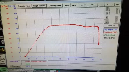

Oh I thought you'd be interested in a dyno graph, we could not figure out how to get the torque out of the machine because it needed rpm reading somehow... and at 175$/h I didn't want to waste any time you know... So here is the power of the Kova EV in function of the speed...

Sounds like you got a lemon, I would check what the lemon laws are in your state and have them do a buy back and get another one instead.

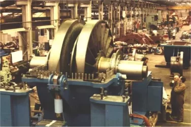

Four decades ago I worked as technical services engineer for a dyno manufacturer so encountered all sorts of field issues with power transmission. Most were engine type dynos rather than the chassis type, both automotive and industrial, to 80,000 hp.
