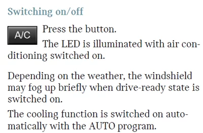

I’m attempting to figure out how to ventilate the SE. Every time I think I have all of the controls set to ventilate I still get heat. How do I turn off heat? I presumed the A/C off and on button also controlled heat, due to the source supposedly being an electric heat pump, but it apparently only turns of cooling only not heating.
This is very puzzling. Any ideas?

Yes. I thought the A/C was broken until I realized I had to either press the A/C button or select the Auto function (to make it work like our Honda). If you have the temperature dialed down and the A/C and Auto function off, you will be ventilating.

Well, yes, but I don’t have to turn the dials UP to shut off the A/C, I can simply press the A/C button. Apparently there is no heater button. So, the default setting is heat always on. That seems odd to me since I presumed both A/C and heat are electric.
The default isn't heat always on and I don't know why you think that.
If you want it cooler, turn the dial to a smaller number. If you want it warmer, turn the dial to a larger number. Whether it blows cool or warm air depends on the interior temperature and what you have it set to.
The A/C button turns the compressor on and off. If it's humid, having the A/C on will remove humidity from the air (both hot and cold air).

I believe the concern relates to the ability to manually shut off the heat. The SE appears to have no override in prohibiting the heat pump from running, if the HVAC is selected on (regardless of AUTO selected on/off or AC selected on/off) the heat pump may be activated if an adequate temperature differential is measured.
"AC" OFF appears to prohibit cooling using the heat pump OR prohibit dehumidification using the heat pump. But heating using the heat pump will continue.
"AUTO" ON or OFF doesn't prohibit the heat pump from activation from the scenarios I ran thus far. If one chooses to ventilate, the heat pump may cycle on and off (for heating) with little control from the driver.
But if there is a way to manually lock out the heat pump (for ventilation) I'd love to hear it. The lowest selection method (as you mentioned) would work, but only for mild climates, temperatures below 50F may continue to trigger the heat.

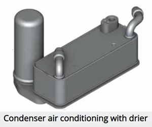

I'm certain the heat pump is used only for heating, not for cooling.
It's the same compressor for both cooling and heating. Valves reverse the flow of refrigerant depending on what cycle is needed.
Any refrigerator, air conditioner, or freezer uses the same technology without the reversing valve. Terminology aside, there is only one compressor for both heating and cooling, but cannot do both simultaneously.
There is most likely a resistive heater to supplement the heat pump during extreme cold weather performance and/or dehumidifying while attempting to heat the cabin.

Thanks for correcting me. I thought I'd read the A/C system was separate from the heating system. I went to a few MINI parts sites and found a heat pump controller but couldn't find a heat pump. The A/C condenser appears to be the only condenser under the hood.
