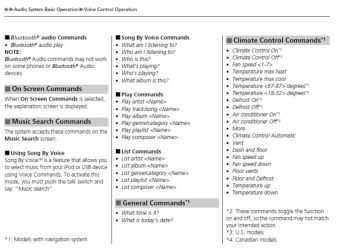

Well, there's the voice control option if you have the correct model...
This Vent Mode 'feature' of the Clarity has bugged me from the beginning. A voice command might be useful here, but alas, it does not work,
I just went out and tried it.. It recognizes the command and repeats it to me, but as far as I can tell, it does NOTHING. I can see no change to any of the climate settings when executing the voice "Vent" command.
It really seems that you have to turn on the fan, explicitly turn the A/C to OFF, dial the temperatures down to LOW, and make sure the external air flow button is on. 4 steps depending on where you are starting from !
