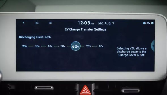

Settings within the car allow you to set just how much of your Ioniq 5’s battery you want to use to charge another EV.
