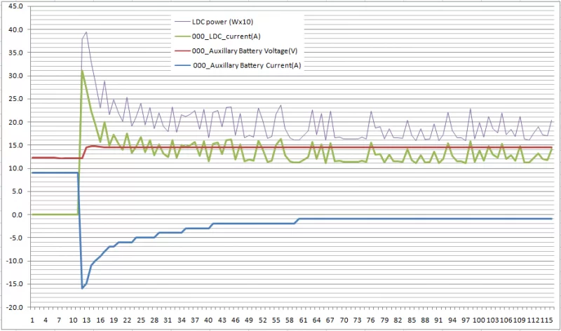

That surprised me as well when I first tried utility mode a year back. I checked it now and it stayed on for over 6 minutes but I know from other times using it that it does eventually give up. Torque Pro works too but doesn't show anything surprising. I could not get the current to spike by flicking the steering wheel, no idea why. LDC output power (just V x A in excel) settles to around 190 watts once the aux battery finishes accepting the bulk of a charge from the 14.8 V system voltage, and that was reflected on the media system's power draw menu.
Horizontal axis ticks are 5 seconds.
Curious to see this graph parked in "run" mode w/ the emergency brake engaged (DRLs off) to see turning the steering wheel activation actual influence on the LDC power. (After the 6 minute settling period);)

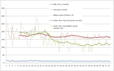

I spent a little bit of time on this today. Between the various modes of Run PB on DRL off, Run PB off DRL on, Run PB off DRL on and in D or R, and Utility, I couldn't see any large differences until I allowed the car to roll and even then it only went up about 100 watts. I didn't have the patience to wait for the PS to go to sleep and I suspect that's where Utility mode might have an advantage, aside from the safety aspect. I'm fairly sure that the dash and media centre remain alight for the duration. Power steering movement did cause small spikes in the current if persistently held off centre.
Next I just did a few minutes in each mode with the PB on.
I'll post the graph with the disclaimer that there is a lack of data credibility because LDC output power appears to be higher than the power supplied from the traction battery. What I have is 5 second logging with a few minutes in Run mode at the start and a few minutes in Utility following. LDC output power is calculated in Excel by volts x amps. Traction battery output power is direct from TP and usually matches well with the dash readout. Because of the noisy nature of the data, I used a running average over 10 samples using an Excel trendline, and those lines are on bold while the source data are the fine lines. About all that can be seen is that LDC output is constant in both modes and traction battery load drops in Utility. If one were to assume that at least one data source has only a scaling error then we might be able to conclude that something is not drawing power from the traction battery in Utility mode. But I would not trust the data at this point.
This was done just at the end of an 'aux battery saver' charge event so there are no initial conditions to ignore.
Yeah, the traction power looks sorta jumpy, so you might have a
granularity problem and rounding is throwing things off at such
low levels.
