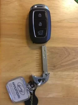

On a FB Kona EV group, a dog owner posted this advice that lets us leave our dogs in an air conditioned Kona so that we could pop out of the car to have breakie or go to the washroom. Set up utility mode using your instrument panel selection and have your temperature preferences set up. Take the inner unlocking key out of your key fob, and leave the the rest of the fob in the car, press lock on the door handle and exit your car. He recommends putting up a sign in your car window "air conditioning is on for the dogs!" so that someone doesn't break a window thinking thinking they are in the heat. Being a paranoid dog owner, I would park my Kona with the dogs where I can see it if I went into a cafe/restaurant, and I would likely blast very cool air conditioning for them.

It is the reverse. If you take out your manual key from the fob, leave the utility mode running set to a cool temp for the dogs, leave the rest of the fob in the car, and when you exit push the lock button, then the utility mode keeps running. However you can also leave utility on by exiting the car leaving the whole fob in the car (without taking out the manual opening key) and you can use BlueLink to lock and unlock it. Hope that is clear.
