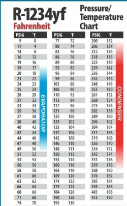

While your cooling is dead, it would be especially appropriate to look at your data. Normally, if a vehicle has at least some liquid refrigerant in the system, you will measure the 'saturation pressure' for that refrigerant when the system is OFF and stabilized at a known temperature (for instance while parked in your garage, and not running). Here is a chart of the saturation pressure for the R1234yf refrigerant that is used in the Clarity:
If your pressure does not 'agree' with this chart when the system is OFF at a specific temperature, then you are OUT of Freon and there is no point in any further testing until the leak has been identified and the system has been re-filled. You should not even operate the system under these conditions...
If your static pressure is OK, then it would be time to do more evaluations with the system running. This is where it would be useful to collect data from other Clarity's with working systems for comparison. If you have some Freon, but it is too low, then this pressure will drop dramatically when the system is engaged (and the compressor will cycle on and off too frequently). You would see the pressure going up and down every few seconds.
A normal system would hold a steady pressure and cycle maybe only once per minute. I would like to encourage those who have Car Scanner working (and live where it is currently hot) to aim for the following data...

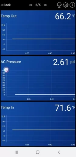

I forgot to mention in my Wednesday post above that I was using your backup from March. Thanks for the updated backup file for car scanner. That did the trick.
I definitely don't have any refrigerant!
I was also able to find the corresponding readings readings in the Data recording section. It was good to see I don't have to have an active connection to the car (so I can use the Dashboard) to access this info.
Wow, you are dead as a door-nail !
Sometimes a dealer is tempted to just recharge the system rather than take the time to properly locate and repair a leak. You can never be sure whether your refrigerant leaked out gradually over 3 years, or did a severe leak develop suddenly... In any event, it is clear that there is a leak which must be repaired.

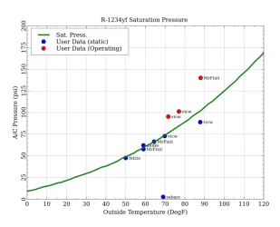

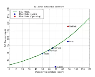

@MrFixit - You have again provided something for me to obsess over regarding the health of my 2018 Clarity. Thank you for the chart and the means of capturing the data.
I just measured my static saturation pressure, with the A/C turned OFF.
Inside/Outside temperature 87.8f., Pressure 89.92 psi
If I'm interpreting my data on your chart correctly, I should have had a pressure around 102 psi, so mine is currently about 12% lower than optimum. So far, my system seems to be providing sufficient cooling, so I'm hoping that pressure deficiency, or loss, is a nominal, long term pressure loss, and not a cliff I'm about to go over. In any case, that reading gives me a good reference going forward

Cooler weather here for the last couple of days, so I was able to capture a couple of recent data points:
Static A/C Pressure
Temperature IN & OUT: 69.8F
A/C Pressure: 72.81 psi
Operating A/C Pressure
Temperature OUT: 71.6F
Temperature IN: 75.2F
A/C Pressure: 95.29 psi
The static pressure which I reported back on May 4th, at about 88F, which was somewhat below the predicted curve, has me concerned that I might have a possible slow pressure leak on my system, so I'm also capturing date and times on my record of the data.
Hopefully some Clarity owners from the south can get us more data points with higher ambient temperatures?

@MrFixit I see you have two static data points on the graph but I only one operating data point. Is that expected?
To ease some burden on you funneling our data, would it be feasible to post the graph and input (spreadsheet?) as a Google Sheets document and share it so we can post our own data? I realize we probably aren't going to get a tsunami of data but the graph will (hopefully) get more busy as the nerds among us check frequently. I especially plan to given that my car will soon be repaired, i.e. check for post-repair pressure decay (leaks).
Static measurements are unrelated to operating ones. I can walk out to my garage any day and take a static measurement at whatever ambient temperature it happens to be that day. For an operating measurement, I need a day that is hot enough for me to operate the A/C while driving for a while in order to reach a stable condition. It has been unusually cool here and I have only had one opportunity so far to obtain a reading while operating.
I'll look at doing the equivalent of this in Google Sheets. I currently use a somewhat obscure, but powerful open source tool called "Veusz".
Regarding the static measurements, I've been limiting my data to report only when the Inside and Outside temps are identical, typically most likely to be at the beginning of the day, when the car has not been operated for quite a few hours, and the temps have equalized. I don't know if that really makes any difference to the result, but it's one less variable to worry about.
