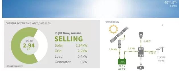

Selling power from the panels will not be significantly impacted from the addition of batteries. There will be some loss through inefficiencies as the panels will send power through a charge controller and then to the batteries. See photo below of our monitoring system.
During a power outage the panels will be isolated from the grid. They will continue to provide power to the batteries and inverter, which power specific circuits in the house.
To my knowledge, the energy stored in the batteries cannot be sold to the power company. My preference is to keep them charged so that we have the energy available when needed. It is possible to open the main breaker, which simulates a power outage. This puts the house on battery back up power and we would, at that point, no longer be consuming power from the grid. We do that periodically to test the system and measure battery performance.

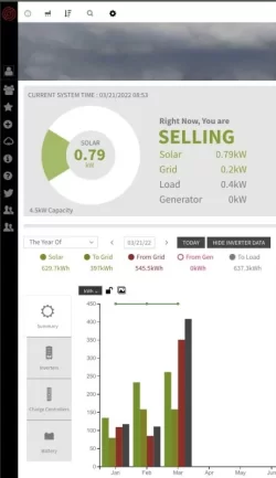

To be clear, unless we have a power outage, or I am conducting a test of the back up system, the energy in the batteries is not being used and replaced on a daily basis. They are maintained in the float stage at full charge. Put differently, the first X kWh’s of solar generation each day are not being stored in the batteries. We’re selling everything we don’t use, just like you. The only difference is that I usually don’t know about a power outage until my neighbor calls and tells me the power is out.
Here’s a YTD report. We were out of town for January-February, so usage was low. The online data recording was down for a few days here and there, as well. It is cloudy right now, hence the low output. The upgraded system, from 2.85kW to 4.56kW came online last September. We expect to sell enough electricity to cover 7-8 months of usage. There is room to increase the array to 6.8kW, which would probably cover the entire year. 38B9594E-B8EF-4BBD-AB45-AA6969DB037F.webp
