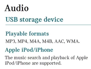

The MINI Navigation/Entertainment/Communication Manual doesn't mention an Android phone as a possible source:
