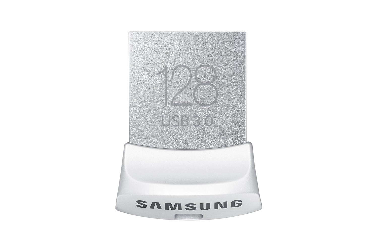

i bought this. Can almost close the usb port cover over it, but not quite.
Samsung 128GB USB 3.0 Flash Drive Fit

That looks nice but since it needs to be formatted FAT32 I think you will only be able to use 32 Gig of the 128 Gig.

I have one of these plugged into a USB port in my wife’s 2016 Pilot. It’s formatted FAT32 and has the whole capacity available. The aggravating part is Honda’s infotainment system in that car limits the size of individual music files so that some are too big to play. The system also resets to the first song anytime you turn the car off while connected to it. Picks up where it left off only if you change the source before shutting the car off and then pick it as source again when you restart.

FAT32 means 32 bits, not 32 GB. FAT32 can make a 16 TB filesystem with 4k "sectors", you just have to not use artificially-limited Microsoft tools to format it. Even Windows will read and write from one that's been appropriately formatted, so I expect the car wouldn't have problems with the size alone.

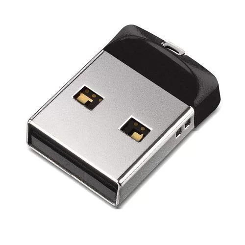

Playback is finicky for me, as well. Some mp3's will stop mid-stream. I can often replay them in full. Mostly, the bulit-in player works, and the mp3's are sorted into Root -> Artist --> Album --> song1.mp3 ... I did have the unrecognized / unsupported file error issue. Reformatted to FAT32 (again) 4096 Bytes unit allocation size, and it's all good. Used the following SanDisk and the USB cover closes completely --

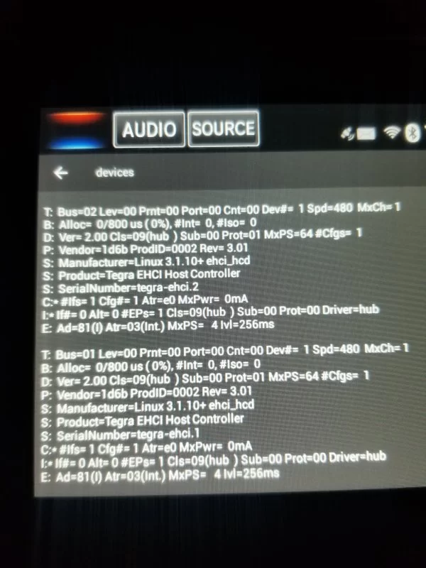

Has anyone tried to mod the kernel or other system settings?

That is correct. I use a 64GB formatted FAT32 with an utility I downloaded. It works fine except it is annoying when you have too many nested folders. Subfolders are of no use.
