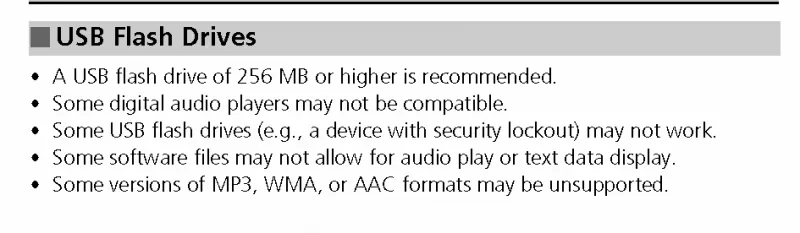

I, too, have a 128GB drive plugged in and leave it there: SanDisk 128GB Ultra Fit USB 3.1 Flash Drive - SDCZ430-128G-G46. This is from page 292 of the manual:
