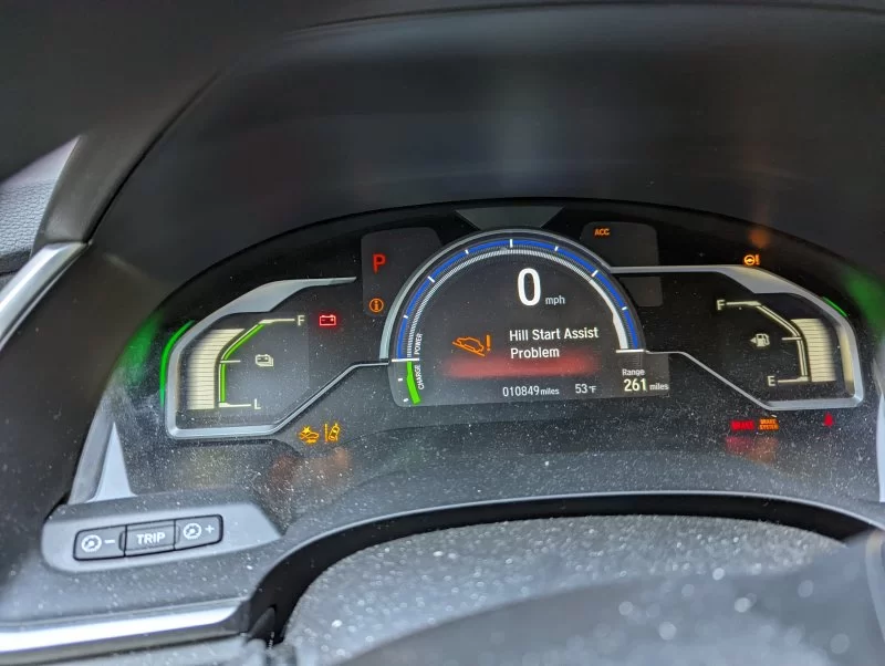

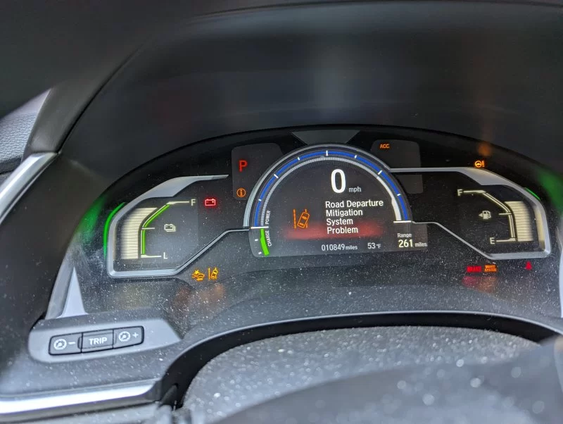

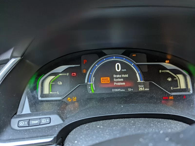

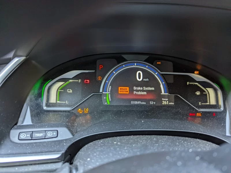

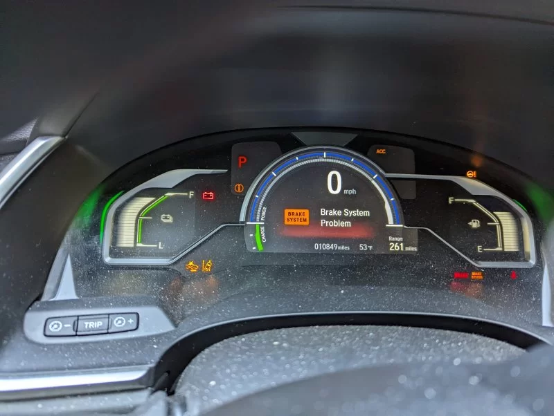

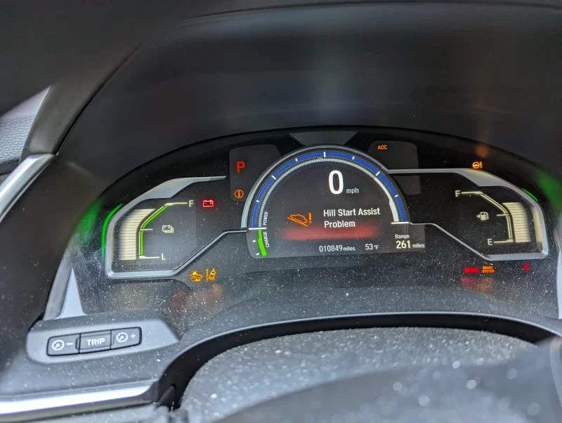

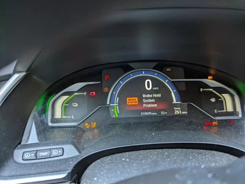

PXL_20211212_170954825.webp PXL_20211212_170949036.webp PXL_20211212_170936057.webp PXL_20211212_170944621.webp Yesterday I took my 2018 Clarity to a local shop to replace the factory speakers with a JL component speakers/tweeter plus install a Viofo A129 dashcam. I also put in a mini self powered subwoofer (without amp)
The resulting sound was so much worse than the factory speakers (I only replaced the front ones). The sound was unnaturally high with the treble hurting my ears. Since it was at the end of Sat, the installer told me to come back on Monday to further troubleshoot.
The Viofo dashcam was installed with the Parking Mode enabled (with the special cabling).
This morning my Clarity will not start as it gives me several errors consecutively:
Road Departure Mitigation System Problem
Hill Start Assist Problem
Brake Hold System Problem
Brake System Problem
I believe the installer probably 'killed' my Clarity due to faulty speaker electrical wiring or maybe the dashcam parking recording ate up all the electric power from the car??
I tried charging the car this morning. The charge will not start (either by the key fob or the Honda app).
The Honda dealer isn't far from my house but I'm afraid to take it there without the car installer to un-do any electrical changes he had done to my car. Even though the Clarity is still under warranty, the dealer can charge me for any repairs that's caused by external tempering.
Even though that, the car's computer may still contain history of any prior error code.
What should do on Monday morning (tomorrow)? Any idea what might have caused the problem? I disconnected the powers to the dashcam and the sub to start.
I have attached the error pictures
View attachment 14424 View attachment 14425 View attachment 14426 View attachment 14427

This array of ominous warnings is caused by a loss of 12V power. The loss could be due to bad 12V battery, a drained 12V battery, or if it was disconnected intentionally during a repair. Once 12V power is restored, you can 'start' the car again, but these errors will not all disappear until the vehicle is driven for a short distance.
