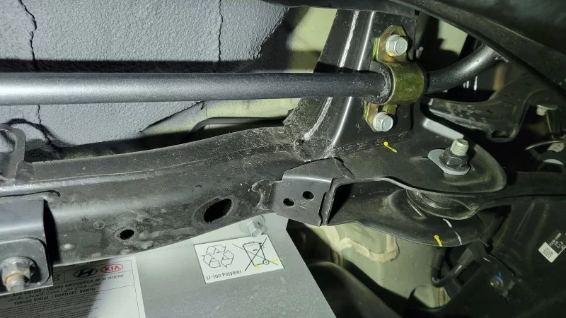

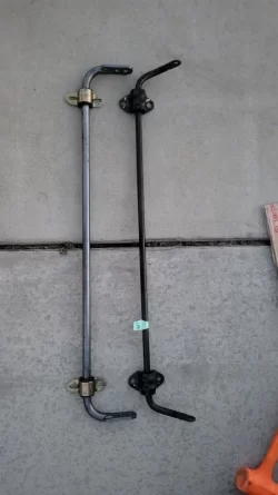

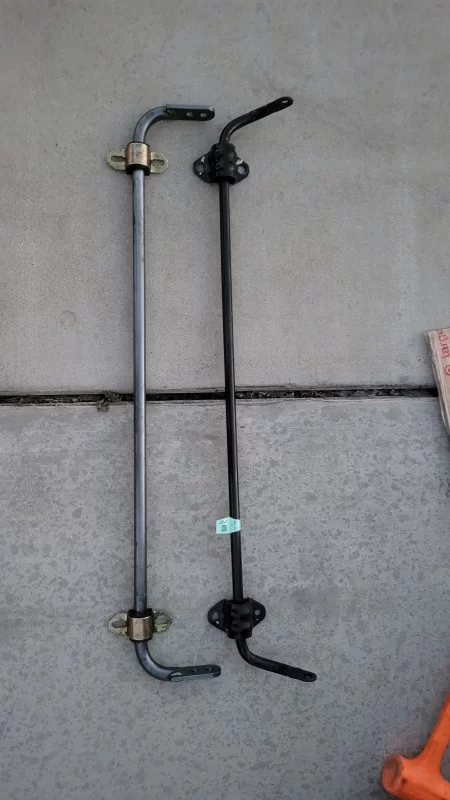

Just wanted to let anyone that is interested in an upgraded rear sway bar for our Niro EV. I measured the stock rear sway bar and it is 15mm diameter. So any of these would be much stiffer.

I got a used Veloster N rear sway bar (Pierce motorsport) from a friend and it fits on the Niro! The car definitely feels more stable in the curves.

I don't think it helps with speed bumps, but definitely noticeable when you are taking the fwy on ramps that are curved, it feels more stable than before. Less understeer.
