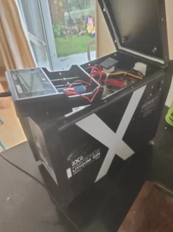

I hadn't recharged it since my shutdown event. Tried it this morning, goes 100 meters then shuts down again, even though battery is showing 50%. Ahh the joys of buying used goods.
I suspect it might be low voltage event due to a bad cell, so popped the battery cover. No luck it's waterproofed with so much glue you can't get the the cells without a lot of cutting away. Not something I'm will to do yet

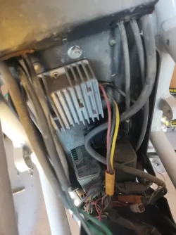

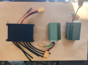

Started taking things apart.
From top to bottom.
48v to 12v step down converter.
Physical wire pull to electrical throttle adapter (small black thing hidden behind wires).
2 x ASI BAC 800 controllers.
The controllers will do 72v but most likely need reprogramming to work.
Overall I'm happy to see decent quality components were used.
Thanks to some sage advice from the folk at endlesssphere I've been able to diagnose my battery issue.
Out of balance cells.
I've got four groups of cells that are out of balance by 0.5v. so that explains the shutting down as the BMS kicks in to save the cells from permanent damage.
So I've rigged up a charger, and will manually charge each group to get them balanced.
So I chucked the charger onto my smart plug that records power use. 2.1kwh used to recharge the battery. Less 10% for charging losses and we're at approx 1.9kwh. Which seems reasonable for a 4 year old battery that's had a hard life.

So I've swapped out the factory controller for a new one that is more easily configured.
I'm running it sensorless so it's rough starting from a complete stop, but once moving it's got a real kick to it.
More tweaking to do.
