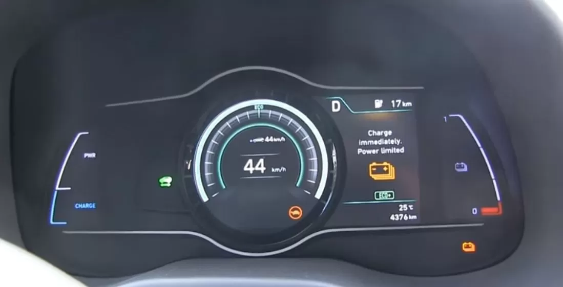

Sorry if this has been answered elsewhere, but I couldn't find it:
When does Turtle Mode kick in on the Kona Electric? And is it a progressive thing -- like a certain speed limit at one SOC, then a lower one later, etc.?
I'm planning a trip in which I might go about 200 miles, much of it at highway speed, before a charge. If I have to put up with, say, 55 mph for a few miles, it wouldn't be the worst. But I'd like to know what I should be prepared for.

From what I have read power is somewhat limited within the last 10%:

Generally yes, but it is also battery pack temperature sensitive and/or sensitive to variation to individual cell voltage differences at the bottom of the pack ( which may very well be aggravated by a low pack temperature). I have had turtle mode engage at 40% SOC when driving at highway speeds with a concurrent cabin heater load(high amp draw ) and the pack temperature being in the -10C or colder range. In this situation with higher SOC sometimes I could kick it out of turtle mode by reducing the electrical draw on the battery by either slowing down or turning off the resistance heater at least until the battery heater can warm up the pack.

I think mine kicked in at 3% on the highway. It was a couple of years ago, and from what I remembered my speed reduced significantly. I was lucky there wasn't anybody behind me, else I probably would have been run into. I had to turn on my hazards to warn any drivers behind me, before I got off the highway. I was about 10km from home, made it slowly with 2% to spare.
