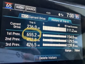

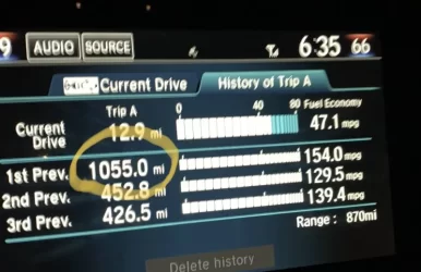

924FE068-9875-453A-A38E-8E748228CC95.webp A97C2332-1C0D-4C4E-824D-3EB1B89AE7AE.webp curious if anyone else is having an issue with the trip computer updating 1st prev drive mileage after 4-5 drives. As seen in photos above. 1st drive reads 1055 miles (selected to reset after filling gas tank). After 4-5 drives the mileage drops in 1st previous drive to 655.2. No other changes to other information for previous drives. I’ve contacted Honda, no help. The dealer reboot/reset system to factory settings, did not correct the issue. Wondering if this is a pervasive software issue or bug in my vehicle...which could indicate other future issues. Any feedback is appreciated. Thanks

I saw this exact same phenomenon on my trip computer. I know, because I decided to measure how many miles I drove in a month (for my lease).. It was 1141 miles last week, and last night, I noticed that it is now 741 miles for that same trip. Strangeness.
Same here.
Mine said 1399 but after a few days, it dropped to 845 or something. Not sure why. When I go back to stealer-ship in few month for oil change, I'll ask. Not holding out for answer.
