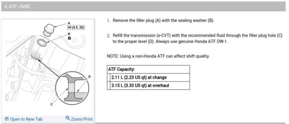

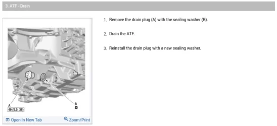

I see that Honda advertises 2.23 qt for a fluid change, and I believe 3.5 qt for a new transmission. Following draining the old fluid, it’s taken over 3 quarts, and isn’t full yet. What’s going on? Anyone else have a similar experience?
How are you determining that it's not full? There's no dipstick and I don't think it fills enough to run out of the fill port. There's an overfill hole for the Clarity, it's below the fill port. Fluid running out of that indicates it's full.
Perhaps you have just put too much in [without openning the overflow hole]?
Although I don't have actual experience yet, I will offer some images to help clarify the location of the drain and check holes:

There's a rubber fill plug in addition to the "filler plug hole". I think you may be filling it from that rubber fill plug and expecting it to run out, but the filler that @MrFixit is highlighting from the maintenance manual is in between the level of the drain plug and rubber fill plug. That plug should be overflowing, not the rubber one. If so, if you remove that one the excess should run out.

As a constructive matter, I tend to trust the manual on this*, and even if your fluid level was low [but not totally empty] before you drained it, if you drain it on a level surface it should retain the [3.15L-2.11L] = 1.04L of undrainable residual fluid.
Thus i'd clean the drain basin well, drain it, and refill with 2.11L of either the fluid you drained [not preferred], or [if you are willing to pay for another 2+ bottles, which i would do because contamination is REALLY bad] new fluid.
Also, note that all bets are off WRT what's retained or when it will run out of the fill hole if you didn't drain it on a level surface, so I wouldn't use ramps like the video does if you are relying on the manual and not the amount removed.

Thanks for the mostly constructive replies. Even after looking at the images extracted from the manual, it’s not obvious to me where the correct fill point is. Blindly following youtube videos, I used the upper port, which of course provides no clues about reaching the specified level. Mrfixit, you are absolutely right that precisely measuring on the input side would have saved the day. Didn’t happen. And of course draining excess fluid without the vehicle being level wouldn’t be good.
So I’m looking at a drain and refill, probably with new fluid.
Fill point located; excess fluid drained with vehicle level. All is well.
It seems that locating the fill / check hole can be a little tricky even with the diagrams.
Having been through the experience, is there a way that you can describe the location in a way that is completely unambiguous for the benefit of others?
