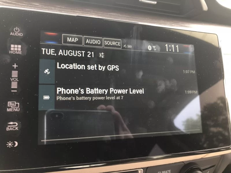

Thanks. From the home screen swiping down will give me some info (see picture). I still can't find a location sent from the Hondalink app. It worked the very first time I tried, but not since.

at the top where it shows your phone battery charger l state there should be a location icon that looks like a tear drop. So looking at your pic, the car didn't receive the sent location. Try resending and look for the icon again.
