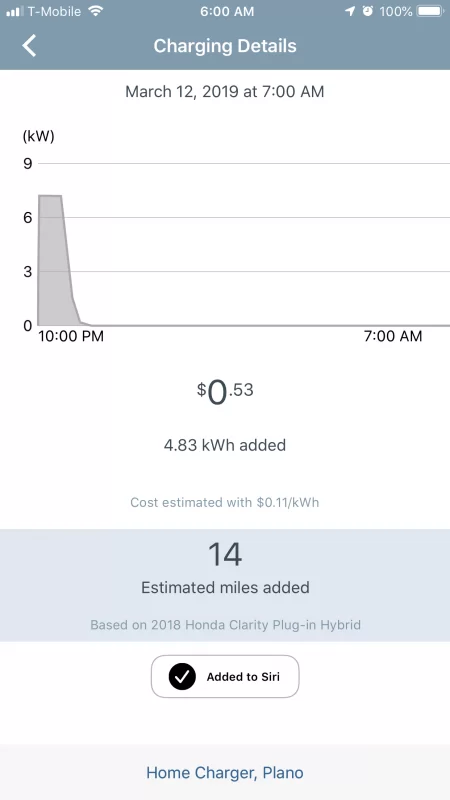

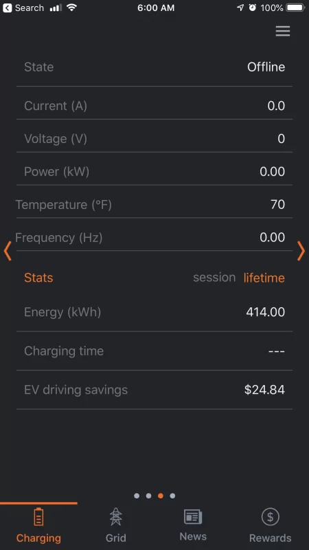

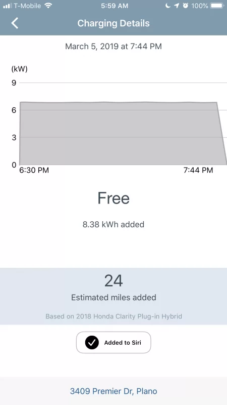

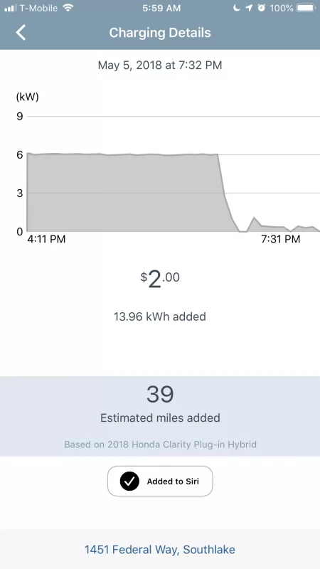

Get WiFi to track kWh usage, know that many public chargers will not five you this information. I’m using ChargePoint home and a JuicePlug (away from home and charging on 120v). I try to charge at ChargePoint stations, even the free ones give kWh used.
First are different ChargePoint sessions, my home, a paid public session, and a free public session. The second two are captures from EV JuiceNet.
Both units allow for information to be downloaded in CSV format.

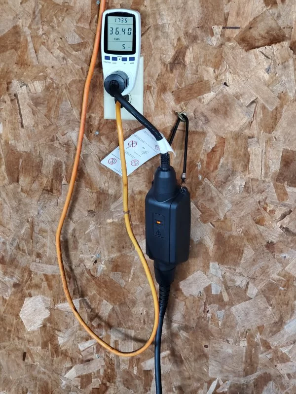

My L1 charger is sharing an outlet with my garage door opener.
Mine is too. You just have to plug the meter in on the top. Following the directions in my old Prius Plugin manual, I suspended the rather heavy EVSE controller from a cup hook to take the weight off the meter and the plug. With my Prius cord I used a zip tie to hang it on the cup hook. (It only had one eyelet.) With the Clarity charger, I used a little bungee cord that hooks into both eyelets, as you can see. The orange cord is the extension cord for the garage door opener.
The only problem I have found with this meter is that it is quite difficult to pull the plug out of the meter (especially since I have arthritis in my hands). It was the same with the Prius charger. It was also the same with the K-A-W which is what killed it. When I pulled the Prius plug out the whole meter broke apart. I was worried that the same thing would happen with this one so I did not unplug the Prius cord at all, but when I had to take the car to give to my daughter, I was able to unplug the Prius with no problem (aside from inadequate hand strength). When I drove the Clarity out to my daughter's for Christmas, I was able to unplug it as well and it is still going.
I have never bothered to input the electricity price to have it calculate for me. I just ask the HOA treasurer at the end of the quarter for the price and multiply by the kwh which is the large number in the middle. It has about a zillion settings, other than the ones you can see, most of which I have never used. 4-5 years on it is still working for me, but like all manufactured goods, I am sure there are lemons.
