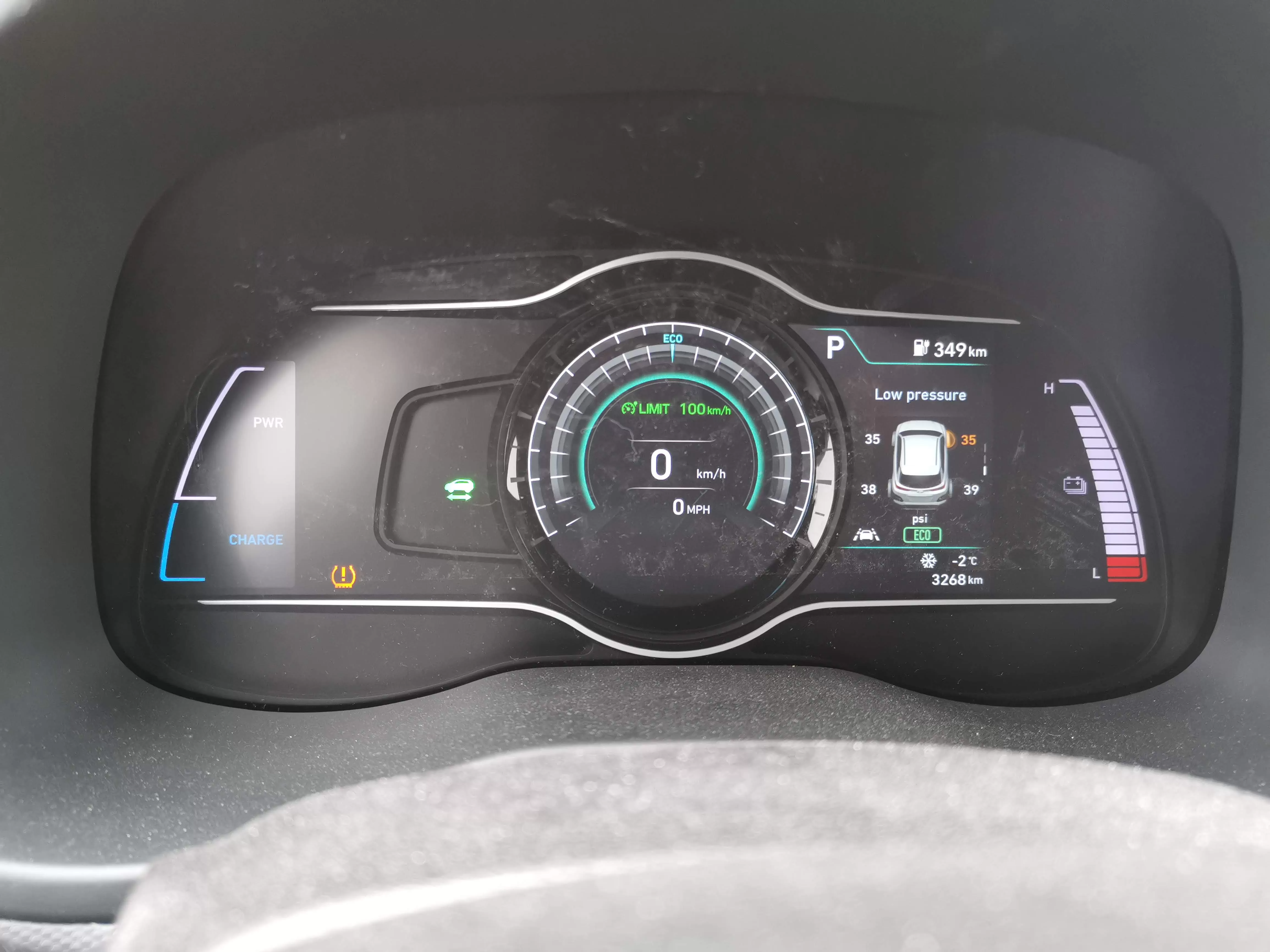

After I installed my winter wheels to the front of my car (they don't fit the back for now), I did get a warning because the front right wheel was under inflated at 27psi
But I've corrected the situation since then as shown in the next picture where both of my front wheels show 35psi but despite this the warning light did not go away.
Does anyone know how to proceed to make the warning go away?
Inflate then a little bit more, 35 is right on the edge. I had the same problem after it got cold here in Las Vegas and because of that the your pressure dropped. I filled them up to about 35 but it still warned me. So I gave it just about 1 more psi and then it went away.
Thanks I will try. However, if you look at my first picture the left tire was previously at 30psi and it never triggered the warning only the right tire which used to be at 27 and is now at 35 same as the other front wheel. Unlike my original wheels which were 17 inches , the max psi on the winter tires says 35 psi.
the warning seems to only come on when 27psi is reached, and it seems to need a little over inflation to get it to quit. I had it happen to me with a slow leak. After repair, they only inflated to 33 and the light stayed on, then they inflated to 36 or 37 and it went away. Of course you also need to drive a few minutes to get it to reset.
I drove it for 90 minutes. ;)
But I will try to overinflate it. Or maybe this can be fixed with Torque Pro?
I doubt it can be fixed with torque pro. Overinflate it a little bit and it should turn off. If you feel like it's too much just release some after it turned off.
You can inflate it yourself with the pump that comes with the car, just don't attach the tire fix goo container.
I was going to inflate it some more last night but the outside temperature went up by a few degrees and my wheels went up 1 psi more momentarily from high speed on the highway just enough to make it go away. :)
Thanks to everyone for their advice, it is appreciated.
