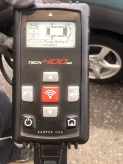

I just installed new winter tires with after market rims. The TPMS I used were a non-OEM brand purchased from my local Hyundai dealer. When the tires were put on my car, the TPMS weren’t picked up by my Kona resulting in a dash light warning. Kal Tire’s tool read the TPMS as dead sensors (they weren’t)— I’ve attached a photo. I subsequently brought my car to my local Hyundai dealer who explained that the sensors (via an ID number) need to be entered into the car/paired as a one time thing. They were kind enough to do this for free. TPMS is now working. When I switch out my wheels seasonally now, I’m told both summer and winter sets will automatically be recognized.

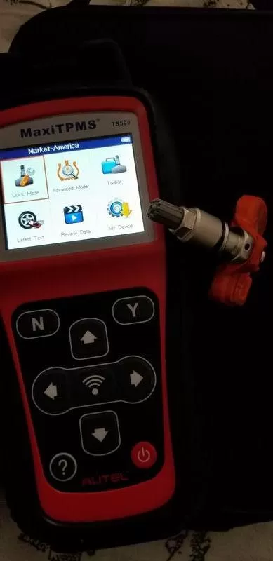

Yeah some of the TPMS scanners are sensor specific. I use a pretty decent Autel tool, reads other sensors and can do diagnostics on them but it can only reprogram autel mx tpms sensors. The sensors themselves are pretty decent, cheap(around $35) and can come with dual frequency capabilities.
