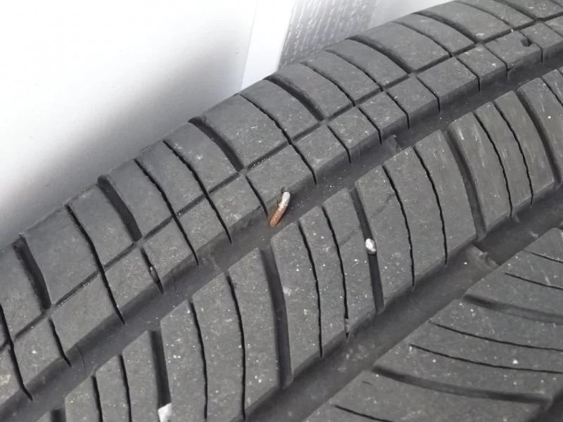

I wanted to reflect on a recent TPMS experience. While driving along, a TPMS warning appeared. Naturally, worrying about a flat, I stopped to check out the situation.
First problem - The TPMS (although I am certain it knows) does not provide any clue as to which tire(s) may be low. So, I go around checking all the pressures and sure enough, the rear driver's side tire was low (around 28 PSI). The others were all very close to the desired 36.
I examined the visible tread area and didn't see anything or hear any hissing. So, I filled it back up to 37, and started driving again.
Second problem - Even though the tires were all back to nominal pressure, the TPMS warning persisted. The vehicle latches the TPMS warning and it will not go away until you perform a TPMS calibration. This is a problem because I had no idea whether this was a slow leak, or a fast one... I did not want to do a TPMS calibration without further knowledge because doing a calibration while the tire is leaking is a bad idea. It should have used the previous calibration (and removed the warning) until I chose to re-calibrate it.
So, without any additional help from the TPMS system, I had no choice but to repeatedly stop and re-check the pressure of the bad tire in order to know how badly it was leaking. After doing this 3 or 4 times and arriving home with essentially no loss of pressure, it was clear that this was a 'slow' leak.
I removed the tire which allowed me to thoroughly inspect it, and was able to easily find a nail:
I could see why this leak would be slow and it looked to be easily repairable. I took it to the local tire shop and they patched it just fine. Now, at this point, it was OK to re-check all the inflation's and do a TPMS calibration.
Here is what irks me... The whole principal of this TPMS system (where it doesn't measure the tire pressures, but rather, looks for rotational difference between tires) has been questioned before in this forum. Be that as it may, Honda failed in mechanizing this system. With no additional cost (only a small software update) the system could easily report which tire is at fault. Also, if the fault goes away (ie: you add air pressure), why not clear the indicator to be able to perceive additional air loss while it doesn't make sense to do a calibration without identifying what the root problem is?
Yes, it detected a real problem - and I am grateful for that. It could have been much more useful however.

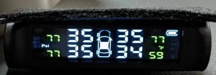

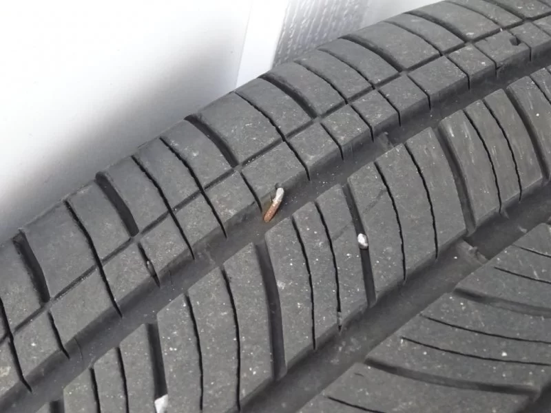

If you wonder what that fuzzy stuff at the top of the unit is, unfortunately the display doesn't change brightness between daylight and evening, so I added a black felt shield there to avoid bright reflections in my windshield while driving at night.

Is there a reason why in the picture of your display the right front tire is not there, is that supposed to indicate something? Or is it always like that?
it really doesn't take long to notice that the failing sensor is not not being updated,
I had no problems recognizing that I had battery failure.
How long does it usually take to notice that it has stopped updating? How do you know when this has happened?
I'm not saying that I question the value of using one of these sensors because of this, certainly it's better than having no information. I am questioning a software decision that I don't understand why they are doing it this way, and I'm wondering if all of them work like this or just some of them.
