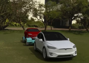

In Towing the plane scenario, it was only possible, with a wagon / Zero tongue setup.
There would be no drawbar weight exerted on the rear suspension system, tires or axle components in the Tesla or the MINI.
All trailers are equipped with either electric or hydraulic brakes that will energize when the tow vehicle applies brakes or slowdown. There will be no disaster going downhill, exiting or entering highway ramps.
To allow electric cars and trucks to take advantage of its true towing capability, a trailer with Zero tongue weight is needed, such as the dolly Pop-trailers, (Wagon hitch set-up). or Self-steer zero tongue weight trailers.
Does anyone know of one?
checkout
http://apdico.net/steerite_self-steer_axle
