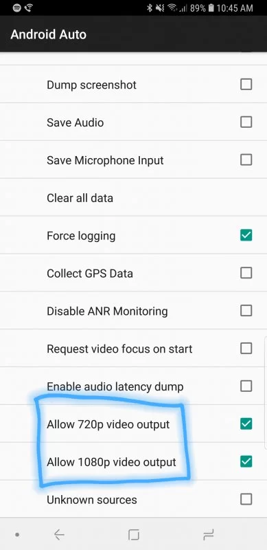

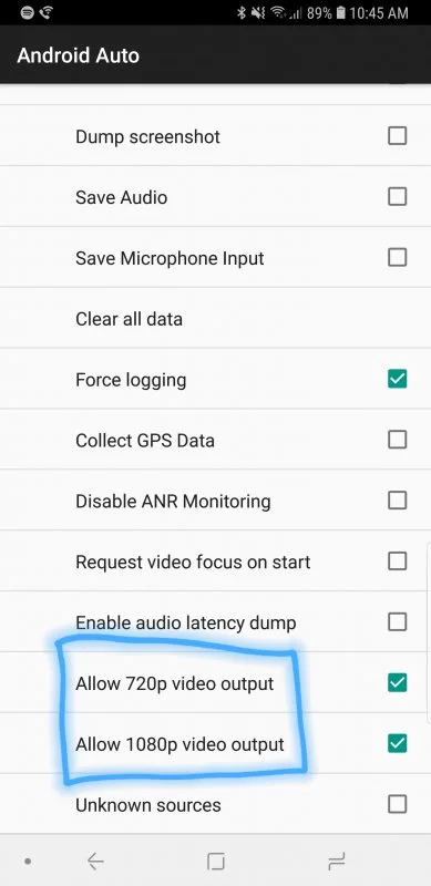

Just found developer settings in Android Auto with these options. I'll try to see if this makes a difference when I can... though I'm guessing this won't do much as the touchscreen resolution is 800x480
interesting, either way, manually switch seems to be the only way I found that works for now. Also had an iPhone with CarPlay, doesn't work as good as Android Auto in my opinion.
