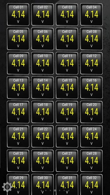

I get the figures using Torque Pro (paid version) with extra PID's from JejuSoul on Github installed into the app
https://github.com/JejuSoul/
It takes an age to set up the 98 PID's for cell voltage, and you also have to set 2 decimal places for each of the cell PID's
I have created a dasboard file which makes setting up Torque Pro easier:-

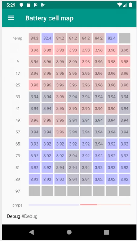

You can also use Soul EV Spy - It's easier to use, but much more expensive:-

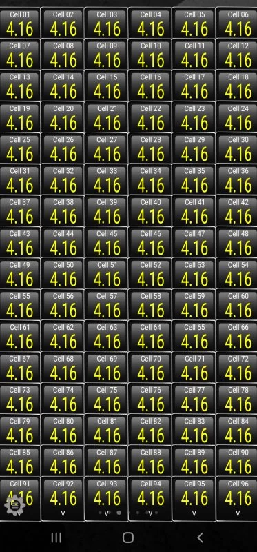

It's a lot of work to define all 98 cell groups to the screen.. There is no way to do all at the same time.. Torque Pro is cheap as you have to do a lot of work manually to make it work.. SoulSpy is basically plug and play. I grouped 96 cells on one page, overlapping each other... Cell 97 and 98 are on another page..
Thanks guys !! I think the SOUL EV Spy is the way to go for me ... a lost less work, and from looking at the LITE version, makes a lot more sense.

I have both - I had gotten TorquePro long before I had the Kona.
One thing I like about SoulEVSpy is that I can reload a previous session that is stored on the phone, and use that to see what things were like in the past.
