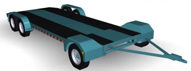

To allow electric cars and trucks to take advantage of its true towing capability, a trailer with Zero tongue weight is needed, such as the dolly Pop-trailers, (Wagon hitch set-up). or Self-steer zero tongue weight trailers.
Does anyone know of one?
checkout
http://apdico.net/steerite_self-steer_axle
