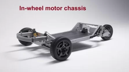

Funny you should mention that: At one point we were told that they had to redesign part of the front frame. As you can see in this rendering, originally the frame members forward of the "firewall" were aluminum extrusions:

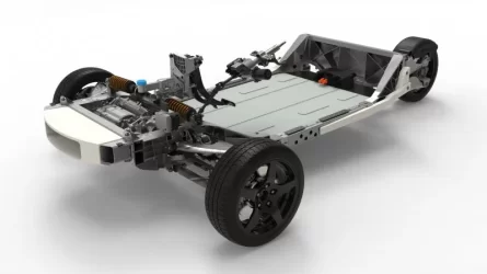

This rendering shows the current chassis with castings and changes to the suspension:
The Vitesco motor/inverter/reduction gearbox unit is quite small: Delivering 150 HP and 229 ft-lb of torque, the Vitesco EMR3 "Integrated Axle Drive" is 22" wide, 14" tall, 16" deep and weighs 168 lbs. - that's smaller than a half-keg of beer, although that keg weighs 8 lbs. less than the EMR3...
