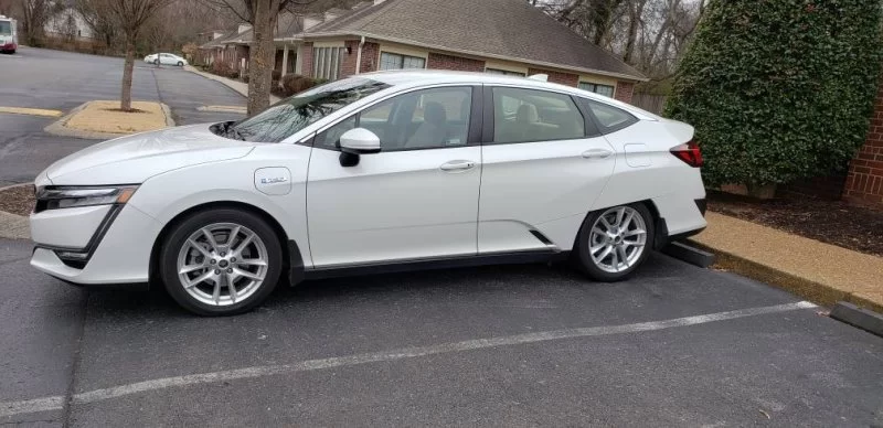

I just installed my fourth set of tires. (91K on the car)
All of the tires have worn excessively on the center line of the tire. I thought this indicated excessive air pressure.
The first two sets of tires were OEM. The third set was 'cheap' Tiger Paw tires. This new set is a little better, but no wear on the new tires yet.
The first set of tires I kept right at 36 psi, and they went 30K miles. The second set I reduced to 34 psi, then 32 psi, and they went 40K miles. The third set was at 32 psi for the life, but after 20K miles two of the tires failed inspection with wear on the centerline. The two that failed were originally on the front, and I put back to the front with the second rotation at 15K miles. The other two tires show wear, but not failed yet. All of the tires have plenty of tread, except for the centerline.
Most of my miles are on the interstate, at 78 mph. Probably 25% is less than 50 mph. Normally it is just me and a suitcase, occasionally up to 500 pounds of equipment. (Covid has not reduced travel for the food industry.)
At the rotations, I am noticing the tires on the front wear significantly faster (centerline wear). Should I use a lower pressure for the front tires? What is the weight distribution in the unloaded car?
