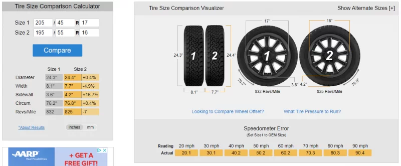

I'm getting a slightly different revolutions per mile number. Also, the overall diameter of the 16" wheel setup is larger than the 17" wheel setup. Is that correct? Check my work:
Diameter:
17: 205/45/17 = 24.26" overall diameter
16: 195/55/16 = 24.44" overall diameter
Circumference:
17: pi*24.26" = 76.22"
16: pi*24.44" = 76.78"
Revolutions per mile (63,360 inches per mile from google):
17: 63,360" / 76.22" = 831.3 revolutions per mile
16: 63,360" / 76.78" = 825.2 revolutions per mile
Maybe the difference in tire pressure between the two setups negates any difference in clocked miles.
While I'm a math guy, I also like well built calculators like tiresize.com's
