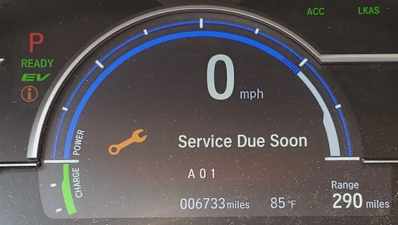

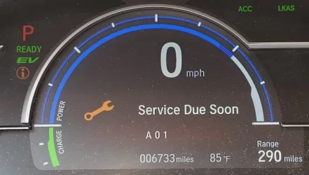

So, I get this on my driver's display:

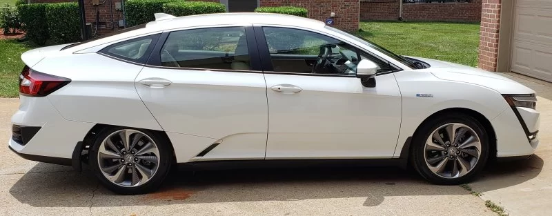

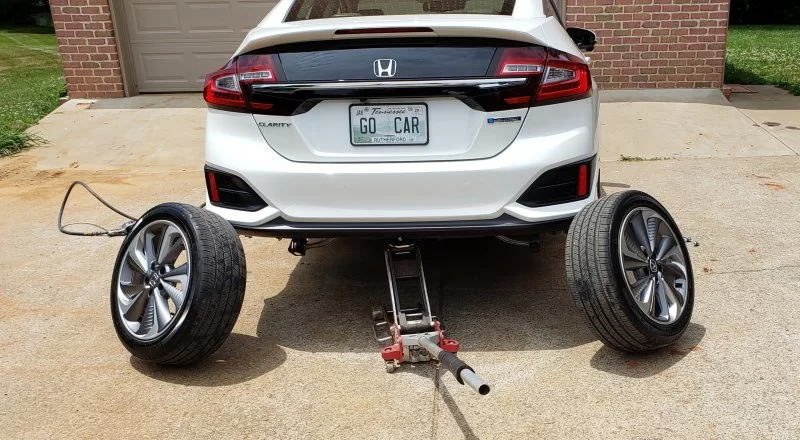

Put my car in nice wide driveway with plenty of room to work:

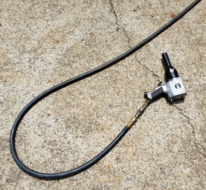

Gather tools:

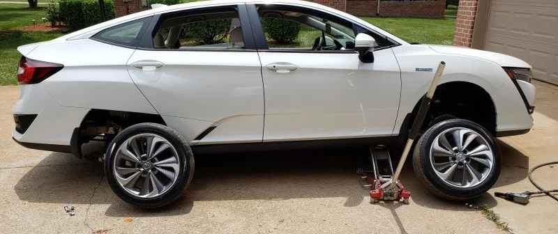

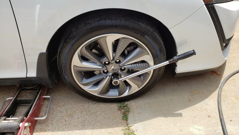

I do a front to rear, rear to opposite front rotation. I swap the rear tires from one side to the other, then sway the tires on each side.
Doing the rear tire swap:
Then do front to rear:
Torque lug nuts to 80 ft-lbs

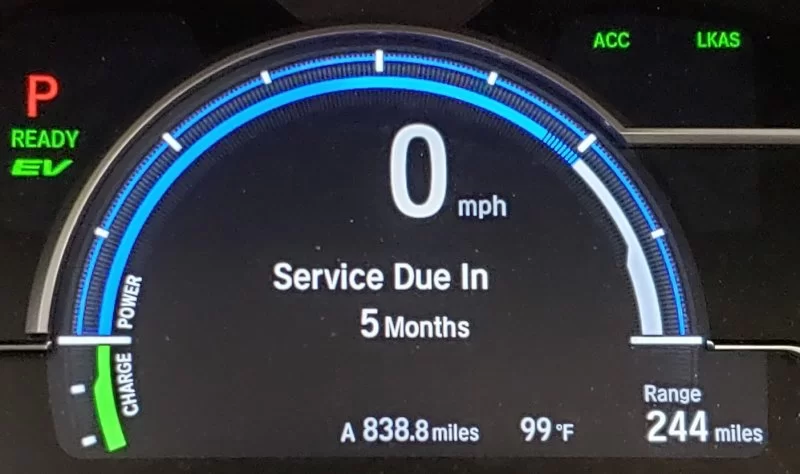

Reset maintenance minder:

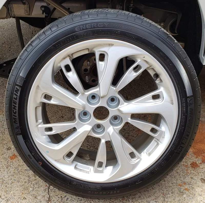

Here's what a wheel looks like without the extra cover on it. Just had to see - curiosity. Ick!
Wonder why service is due in 5 months?

A01 means oil change and tire rotation...
99 degrees in TN ?
Wow - I thought I was baking at 85 degrees in So Cal today..
Several have reported and I can confirm that resetting the tire rotation in the MM will extend the oil change by several months. This is because the MM moves up the oil change to coincide with the tire rotation to reduce the number of service events. I’m sure it’s just a coincidence that this increases dealer profit (sarcastic font engaged). With low total miles and very low HV miles, my MM let me go exactly one year on the oil change after resetting the tire rotation.

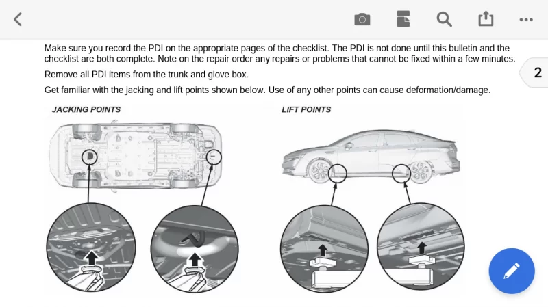

For reference here are the jacking and lifting points from page 2 of the PDI:
God bless you sir for using a torque wrench! (I do too) Thanks for posting the pictures. Except now I’ll probably have nightmares after seeing how hideous that bare wheel is.
Thanks @KentuckyKen, I foolishly consulted only the Clarity Owners Manual. It appears the manual's writers considered those two additional jacking points to be for professional use only.
I rotate my tires when changing the snow tires/wheels, so the amateur jacking points work for me. And I use a torque wrench.
Dang, I've been using the tow eye on the passenger side toward the front as my jack point, the car goes up all crooked and I hate it. Thanks for the tip!

I've been using these jacking points on Honda vehicles for as far back as I can remember. It is nice that for the last 20 years the frames have become stiff enough to raise the entire side of the car from the jacking point behind the front wheel.
