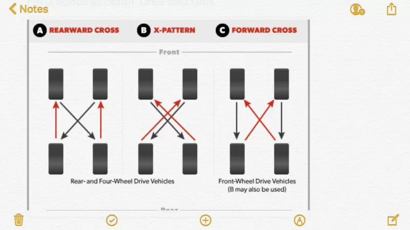

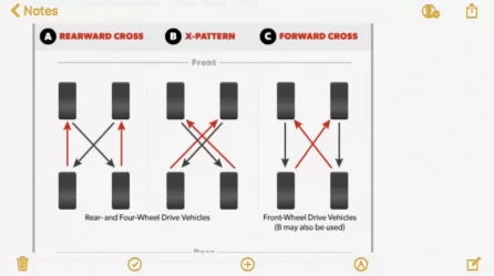

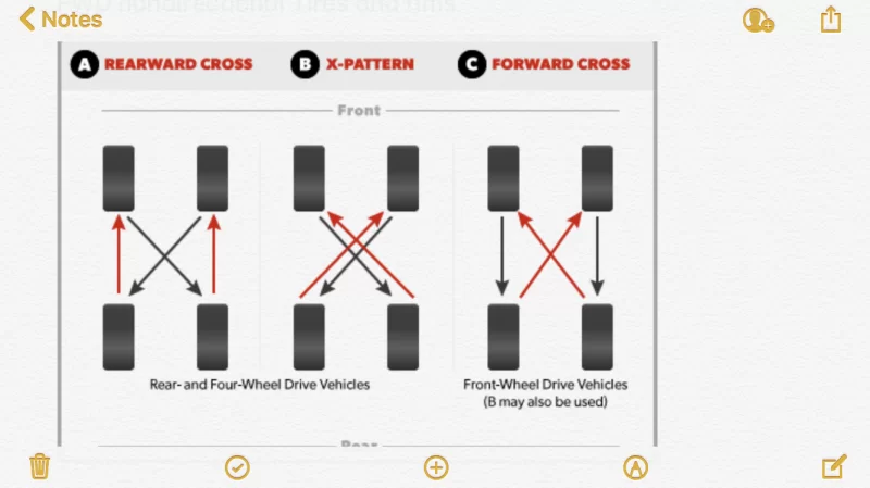

The OEM LRR Michelin’s are non-directional tires and thus can be swapped from side to side. Believe it or not there is an actual Tire and Rim Association which publishes tire rotation recommendations. Here is their info and some Clarity tire and wheel info I gleaned from my always helpful fellow Clarity forum posters.
Tire size 235/45R18 94V
OEM is Michelin AS Energy Saver
55,000 mile warranty, non directional
Wheel size 18 x 8J ET 50
Bolt Pattern PCD 5x114.3
36 psi
19 mm lug nuts
80 ft/lbs torque
The Tire and Rim Association recommends the Forward Cross for FWD nondirectional Tires and rims
