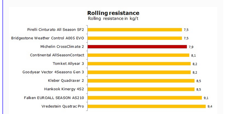

Good thread, and one I've fallen down the same rabbit hole on. You haven't missed a secret database. There's no clean NA rolling-resistance source, but you can triangulate it:
  1. EU tire label: same tires sold in NA often carry an A-E rolling-resistance class in the EU. Check the maker's EU site.
  2. Maker spec sheets: Nokian, Michelin, Continental list kg/t for some lines in their EU technical docs.
  3. Independent tests: Tyre Reviews and ADAC measure RR in parts of their testing.
  4. Real-world data: the kWh-tracking someone posted beats any label for your commute. We need that crowd-sourced spreadsheet.
