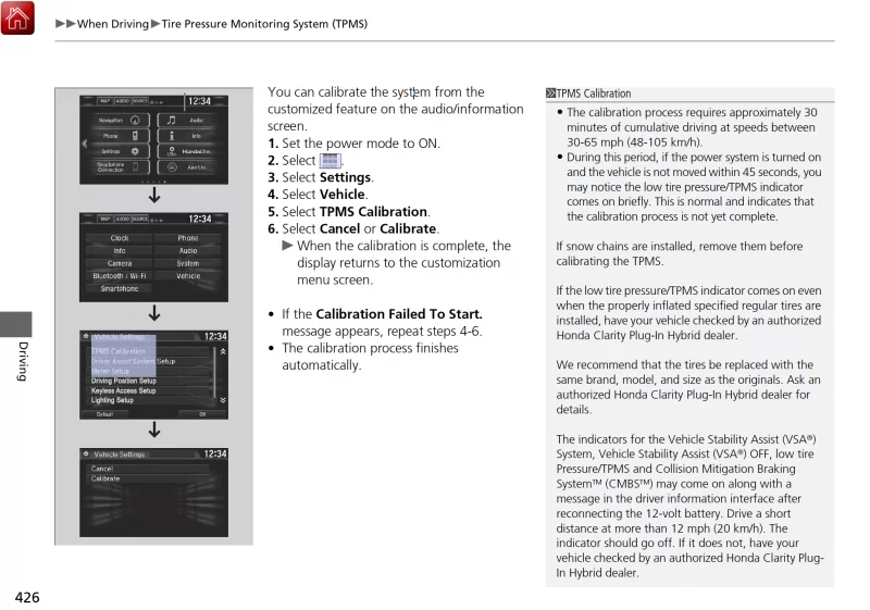

Display showing this message .. I tried with the pressure they advice on the inner side of the door in all 4 tyres (36 psi) .. But the message is still showing that my tire pressure is low ... But all the tyres has more than 40 psi now I lower all the tyre pressures at 36 PSI.. It supposed to show Tire Pressure High .. Anyways , can anyone advice how to get rid of these pls
