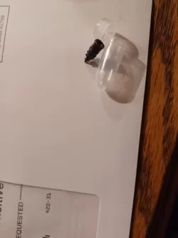

Tire shops vary on what they deem proper and safe. Sam's club ordered a new tire for me about 6 weeks ago under warranty (still hasn't come in) and refused to patch my slowly leaking tire because it would be too close to another patch on the tire. So i removed the screw and installed a screw in plug....bought on temu. About 12 plugs. Tire is still holding air perfectly...
Looks like a "Zip it" for tires.
First time I have seen one, appears to be easy to install. Happy to hear they actually work.
