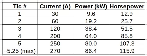

Under this full acceleration condition (my SOC was near 100%), the battery is delivering 270 Amps at 320V. You can equate this to 86.4 kW, or 116 HP.
It was satisfying to find that this is very close to the expected value of 121 HP.

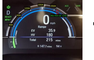

I also wanted to revisit the instrument panel and the power 'ticmarks'. It is a little challenging to hold the power cursor steady while trying to read the current, but this is my best estimate as to the current that corresponds to the 'tics'. @AnthonyW had a post related to this quite some time ago, but I do not believe his estimates were correct. We now have much better instrumentation capabilities...
Just for reference, you can express these 'tic' values in multiple ways:
