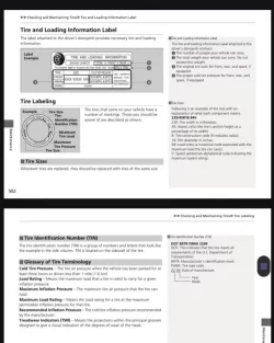

When Google fails, read the manual.
Tire ratings provide information that allow the user to choose an appropriate tire for the intended purpose. Many trailer tires have a Speed Rating of 65mph. Some folks might consider it a poor choice to put trailer tires on a passenger vehicle. Fortunately, tire manufacturers have given us enough data to make an informed decision.
(Moderator's note: This post is a humorous look at tire misinformation found on a supposedly legit site. W is a relatively recent speed rating - good up to 168 mph (270km/h))
Dammit, I bought the 98W, as they were more readily available; and the manual says to use the 94V:)

Take a breath and spend a few minutes on a tire manufacturers website. Look at the charts for Load Index and Speed Ratings.
W is the speed rating as posted previously.
98 is the load index, in this case, 1653lbs.
Both ratings exceed the ratings of the OEM tires. Does that make them “better”? Define better.
