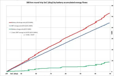

I've tried my own tests on a 30% grade in an attempt to measure the efficiency but failed to get anything useful because the hill was too short. But I have been able to illustrate the advantage on a hilly 300 km round trip by logging energy flowing in and out of the battery. The graph horizontal axis is SoC to simplify the results, noting that the slope of the net energy used is essentially the battery capacity, 64 kWh per 100% SoC.
