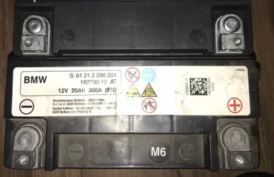

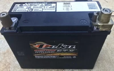

Here are the batteries side-by-side:

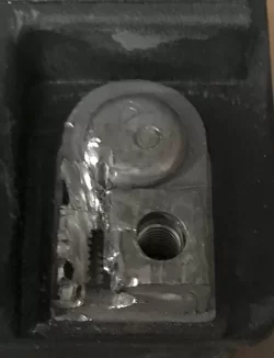

Here it tried to open the space on the substitute battery terminal:

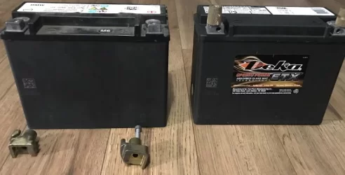

Here is the original cable terminal. The fat part would not fit:

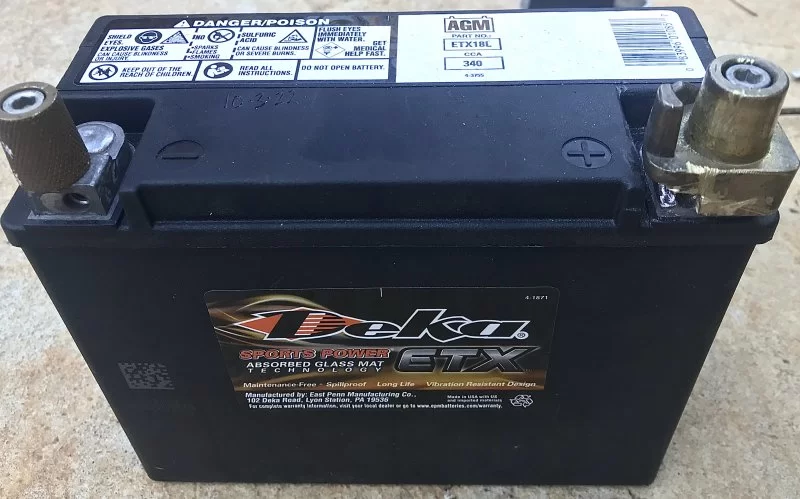

So with a Dremil tool:
