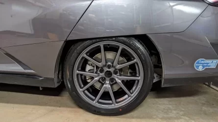

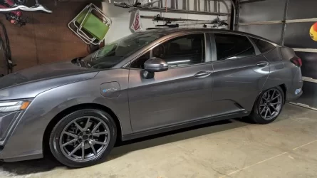

Just throwing it out there in case anyone was interested or curious about whether they fit. Just put the wheels on tonight. Looks like its a pretty good fit. Only drove it for a couple miles so far. No rubbing or other issues yet. My car was due for some tires to I ordered some Hankook Ion Evo AS. While I was waiting for them to come in, I started doing some research on some other options. Ended up finding a set of takeoffs with new tires and decided to give it a shot since it was cheaper than going with the Hankooks. The set up is lighter coming in at 47.5 lbs with new tires while the stock wheels were at 52 lbs with worn tires. I have the aero covers, but I think I'm willing to lose a little bit of efficiency keeping them off. I feel like the rims look too good to cover up.

It is very interesting (and unexpected) that this works...
Apparently both Clarity and Tesla wheels are hub centric (oriented precisely by the hub rather than the lug bolts) with a 64.1 mm hub diameter !
I assume you did not need an adapter ring because of this.
You have demonstrated that the Tesla wheel works on a Clarity (with no interference issues, etc).
Do you think it would also be possible to use a Clarity wheel on a Tesla?
I am thinking more about covering for the lack of spare that seems to exist in all vehicles these days. Some of us went through the process of acquiring an Infinity 'donut spare' to use with the Clarity (this did require a hub adapter ring). Could this spare also be used on a Tesla? Or, for instance, could a Modern Spare for a Tesla also be shared with a Clarity? With both a Clarity and a Tesla, I would like to keep a single spare at home in case there was a need to 'rescue' one of the vehicles locally and only carry it on a 'long' trip.
No hub centric ring needed since center bore is 64.1mm just like OEM. Only thing that might not work with Clarity wheels on a Tesla is not clearing the bigger brake kit on the Tesla.

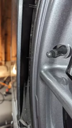

Haven't noticed any rubbing at full lock either way

I've been happy with the wheels. Helps my car stand out a little bit from all the other Clarities in socal. The only downside is that even with being really careful, I still managed to get a bit of road rash on two of the wheels.
