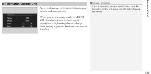

For our Clarity vehicles it specifically refers to the Telematics Control Unit which manages your charging timer if one is set. It also shows a signal strength of the 3G data connection your car uses to talk to the Honda servers for your remote Honda Link app to work. If it shows no bars then that might be part of the problem with your phone connecting as the AT&T data connection Honda has for your car to talk to their servers is out of range or not working for another reason.
You do not have a timer set which is why your dash is displaying TCU Timer Off. If you set a charging start time, then even if the car is plugged in it will not start charging until that time and will stop once charging is complete or at a "stop" time set.
To restart your tablet, push and hold the Audio Power "button" for about 5-8 seconds until it prompts to reboot and select yes. Keep your car powered on until it has rebooted. You can set your head unit to reboot every night if you wish (called a Memory Refresh) and set a time to do that when it is unlikely you will be driving. If you never see bars next to the antenna on the TCU dash display then that may be a problem with your parking location, or something else (similar to your phone being out of carrier range). You can also get odd behavior also similar to a weak carrier connection like being able to receive a text message but unable to send. So your car can send out the charging status, but it is unable to receive messages like start, stop, and climate etc.
See your manual or the app on timer operation, pages attached.
