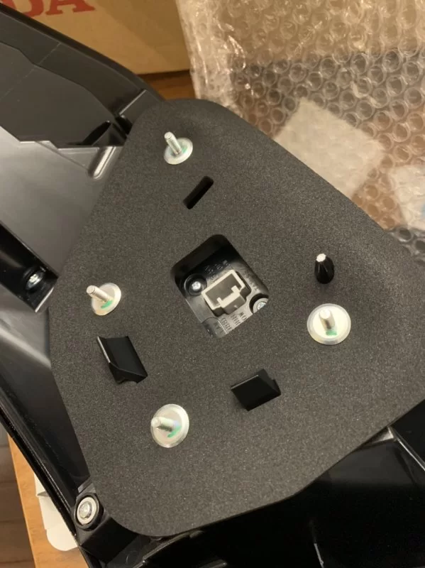

Does anyone know how to remove a tail light on the clarity? Something/someone smashed a hole in one of mine and dealer wants $600 to replace it. The part looks like it clips in, but not sure how to remove the old one.
The instructions on my TorqueLift hitch show you unclip and lift back the trunk lining to access them from behind and remove by unscrewing.
Will pull back the lining and see. I saw the clips and ignored the threads because I was picturing how an accords pops out from the side. Probably unscrew from the back and I clip. For reference here is the back of the assembly.
