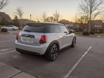

Hi - my son has made it a mission to chrome delete and swap out red for black on my BRG '23. I have to say, it's looking pretty sharp.

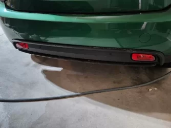

However, he bought gray reflectors for the back bumper and hasn't been able to find a video to watch on how to replace them. Has anyone done it?
He's fairly certain he'll have to rent some time on a car lift, but would love any/all advice beyond that.
Thanks!
[He's already done his, a '15 ICE 2-dr in dark gray - but kept a bit of red to go with his "S" badge, so he hasn't done the rear reflectors...]

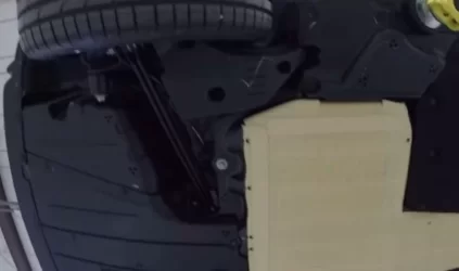

It's a few bolts (8/10 metric?) to remove before popping off the underbody panels. It's probably easiest to use a lift and torque wrench extensions for the hard to reach bolts. I think you can leave the center panel attached and remove the left and right ones (works for ICE version).
Yeah, no lift needed. You can remove 1 8mm bolt behind each fog light to get enough room to get your hand in there to squeeze the back of the fog light housing and it will pop out. Very easy.

Search on YouTube and you'll find videos of people doing this. The undertray is slightly different on an ICE F56 but essentially the same. You just need to squeeze the housing and it will pop out.
