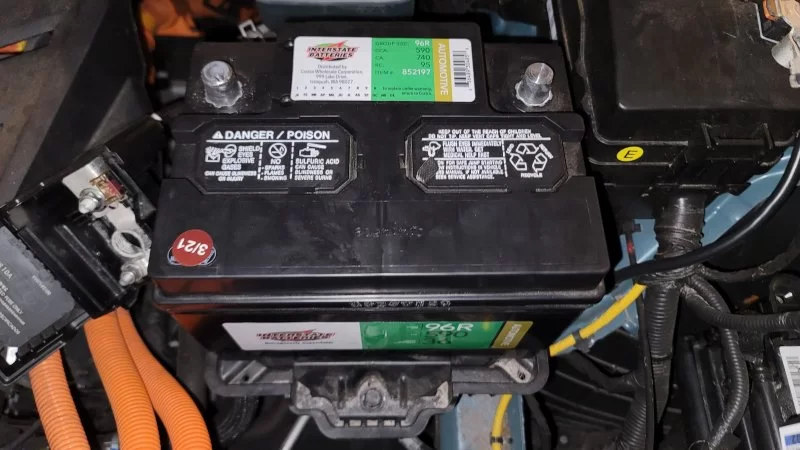

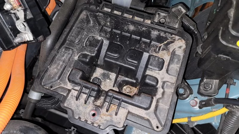

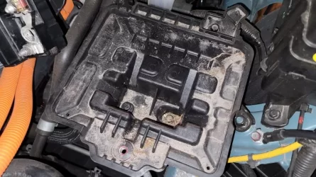

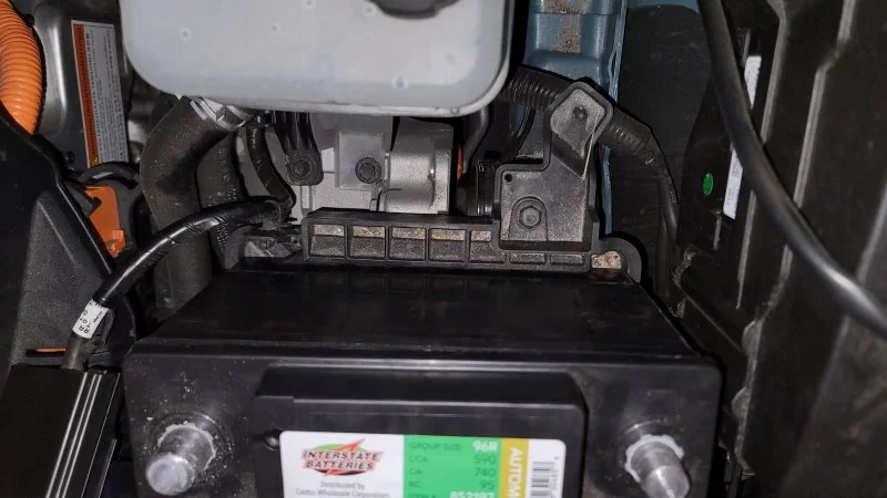

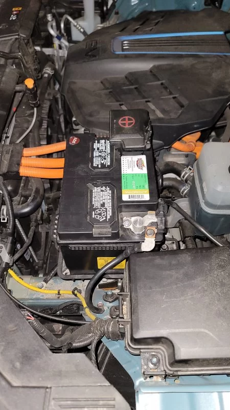

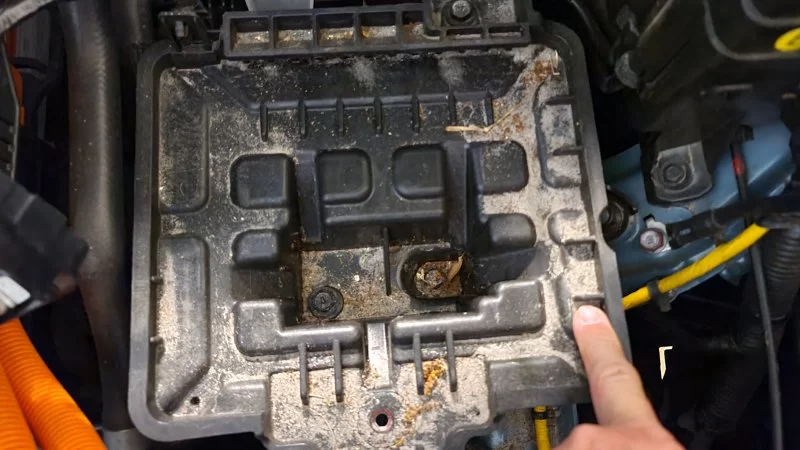

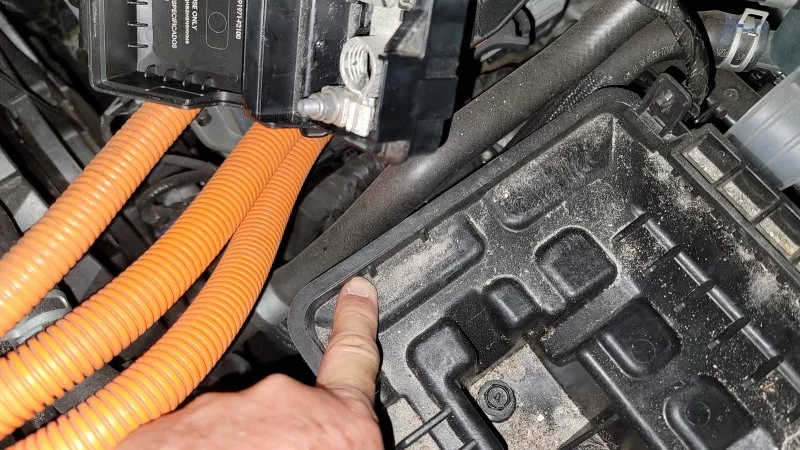

When my Hyundai dealer did all the recall work (other than battery replacement), they told me that my 12 Volt battery was no longer under warranty as the 12 Volt battery warranty is limited to 36000 miles and I'm at 50000 miles.. So, I went to Costco yesterday to get a better battery.. Didn't want to go with the same crappy one.. I will have to modify the battery tray a little to make it fit perfectly.. There are some little plastic fins at the edge (left and right of the battery). The original battery is about 1/2 inch narrower and the fins are there so it won't move sideways. I will grind down those little fins as the Costco battery used the entire battery tray width.. Right now, I found a temporary way to secure the battery but once the fins are ground down, the battery will fit perfectly. The only difference is that you won't be able to use the plastic cover for the negative terminal. INTERSTATE BATTERIES, GROUP 96R STANDARD 36. $96.99
Very neat job, looks (and will probably operate) way better than original;)
The original battery is crap. Too many people have issues with them.. I measured the tray and it turned out that without the little fins, the size of the Costco battery would be a perfect fit. 5 minutes of work and it fit like a glove..
